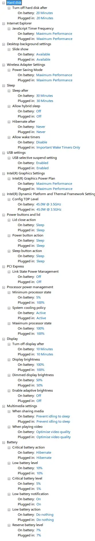

Below are the settings I used for both new plans.
Power plan settings
