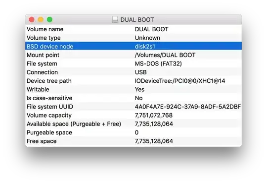

You can find the path of a disk using a built-in tool on macOS.
  1. Go into Disk Utility.
  2. Select your drive by its name, such as DUAL BOOT in my case.
  3. Open the info panel by its shortcut, right-clicking the disk in the list, or as the picture shows.
Info button
  1. Locate the row named 'BSD device node'.
'Get Info' with /dev/ info
The path will be /dev/disk2s1, based on the value of that row.
