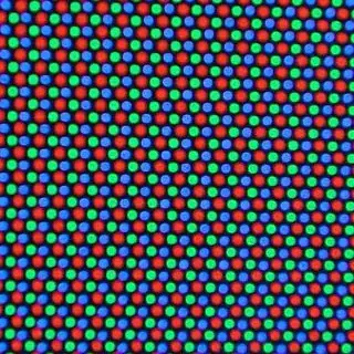

Most computer monitor CRTs have a shadow mask which has a triangular arrangement of colors.
Here there is clearly no way that subpixel rendering can work the way it should. However, you still get the difference in brightness and CRTs being blurrier than LCDs may make the text appear similarly to conventionally-smoothed text (which uses just grayscale to smooth the edges).

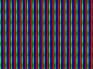

Some computer screens have an aperture grille and I happened to use one of those for several years.
Here you can actually have a similar effect as on LCD screens for ClearType, especially when hitting the maximum resolution of the display (I tended to do so because my eyes work and I valued the space on screen :)). However, there is no guarantee that every pixel will lie exactly at the boundaries you would like it to lie. Also with older monitors the dimensions of the image tend to vary with overall brightness of the image. But at least for me subpixel rendering on such a screen was superior to grayscale antialiasing.

Existing technologies, designed for text (ClearType, Freetype, something in Quartz) - only designed for orthogonal layout with fixed in-pixel layout. However, there are successful experiments downscaling images with LCD subpixel layout awareness (when each subpixel is considered as position for pixel, though 3x weaker and overlapping with others). So - should be no problem trying that with even wich CRT monitor layour, which may be a bit alien, but possible to optimize to.
What should be cared in case of CRT monitor layout as in above picture:
  • It's triangular mesh. However, given that each pixel has one triad on native resolution, it's expected to still have an order. It's just hard to see, when there's no visible border between pixels for eye to anchor.
  • Subpixel layout may see messy, but I see two different layouts per pixel, each reflecting other vertically, just like trinangle, they are associated with.
  • Finally, at in-triangle level layout is fixed. I see stable red in left, green at right and blue at top placement. In vertically fliped variant - entire structure is fliped, but otherwise is same.
  • Normal and fliped triangles are interleaved between columns, but not between rows, thus there are per-row triangular meshes.
  • Each subpixel still belongs to certain pixel, at least at native resolution.
Now, what are possible issues:
  • 2d image usually use rectangular pixel shape. But in CRT monitor they are triangles, elements or triangular mesh.
  • Any maginable pixel in LCD layout is always centered around some pixel. Bee it green, if this pixel is in center of native pixel, or blur or red if it's displaced by 1/3 of native. However, these triangular pixels have center inside triangle, out of all pixels. This may be important when attempting to map regular HD image to this triangular subpixel grid. Thus - calculating color for subpixel position is wrong - they each have 6 more surrounding elements, and including them to minimum pixel area would make pixture rather blurry.

More specifically, the ClearType technology is optimized for LCD panels with red, green, and blue (RGB) striped sub-pixels that are oriented vertically, although it performs reasonably well on CRT displays (especially those that are aperture grille based) and even LCD panels with horizontally oriented RGB stripes. Although this might seem counterintuitive, through informal studies, we’ve found that about 70% of users prefer ClearType even on these non-optimal displays. Of the 30% who preferred other rendering techniques, their biggest concern with ClearType in these non-optimal cases was the loss of text contrast.
