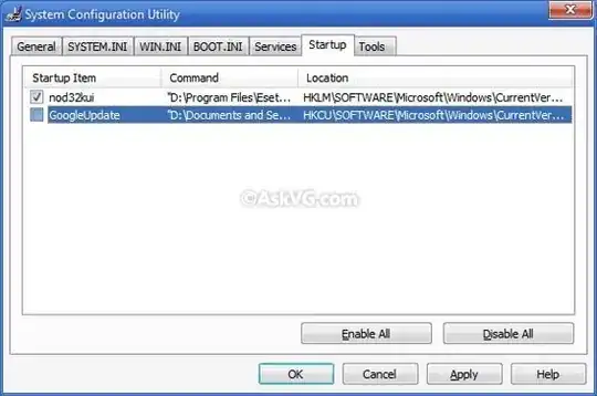

1) First disable "GoogleUpdate.exe" from system startup. Type msconfig in RUN dialog box and press Enter. It'll open "System Configuration" window. Now goto "Startup" tab and uncheck "GoogleUpdate" from the list.
Apply the changes and restart your system.

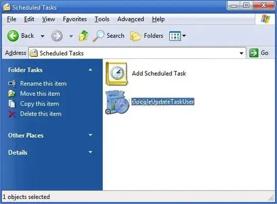

2) Now we'll need to remove the scheduled task created for GoogleUpdate.exe from our system. Open "Scheduled Tasks" or "Task Scheduler" from Control Panel or Programs menu. You can also run it by directly providing "taskschd.msc" command in RUN dialog box or by opening "%windir%\Tasks" folder.
Now look for the "GoogleUpdateTaskUser" task and delete it.
XP:
Vista:
You can also disable the task instead of deleting it.
