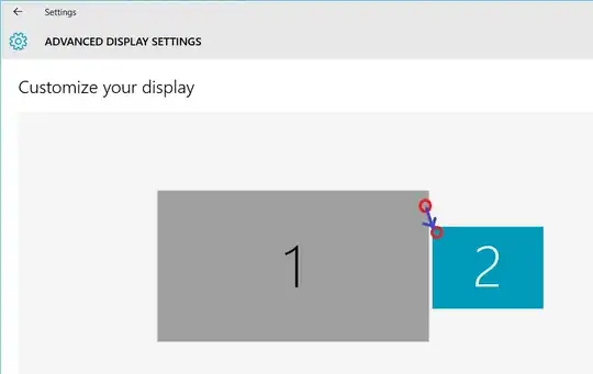

As for why Windows doesn't do this, I actually find the opposite behavior to be most useful. Diagram of monitor arrangement
I use the tiny edge at the top-right of monitor 1 to catch my mouse when I want to click the Close Window button.
Ideally, Microsoft would make an option for either, but until then, at least there's DisplayFusion.

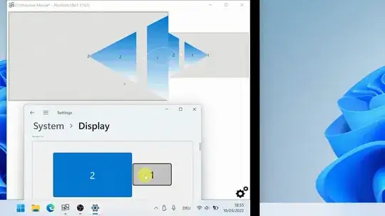

Continuous Mouse will also do what you are looking for.
I programmed it for the sole purpose to customize the transition between two monitors of different resolution.
https://www.microsoft.com/en-us/p/continuous-mouse/9p6nts4k5425
With Continuous Mouse you can also leave out e.G. the upper area to make it easier to reach the close button.
Here is an example configuration: Example Configuration. in the background is Continuous Mouse

  • I adapt my answerer according to the existing answers. Sadly, even in 2022 Windows doesn't provide a build in solution for the purpose, and therefore I need to reference an app that fixes the issue. – mtooling May 10 '22 at 22:40
  • The benefit of Continuous Mouse is that it allows custom transition like in the GIF and also transitions between multiple monitors on one side. – mtooling May 10 '22 at 22:43
