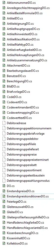

I have a folder with 120 .cs files.
What I need to do is add "DO" to every files name, before the extension.
Heres what i came up with:
ren *.cs *. //this removes all file extensions
ren *.* *DO.cs // this should rename all the files and add the suffixes
Now, this works mostly. But not for some Files.
Initially, I thought that it was just the files starting with Do
But... well, here is how it turned out:
folder-view
(The rest thats not on the printscreen is fine)
Now this aint a serious problem; id just like to understand why it did this...
There is my cmd output: cmd output
From looking at this output i thought maybe it cant find the files because the second command consists of . for the renaming; but since none of the files in the folder has a file extension at the moment of renaming; this cant be it..
Thanks

As others told, it lies in the way ren interprets wildcards, that's why it can't find files that contains dots *.* in second command, because:
  • You not only removed file extension using first command, but also dots before the extensions:
Artikelnummer.cs > Artikelnummer
  • And your second command is looking for filenames containing . (which there's none!):
ren *.*
  • Also consider ren uses * to refer to file name, so when you look for *.* (any name, any extension) you're using * to refer to filename and extension at the same time, which is confusing to ren command!
So, the conclusion is, the only problem was *.*, replace it with *:
ren *.cs *.DO.cs
ren * *DO.cs

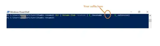

I was looking for a way to add suffix "_t" to my images.
Just one simple PowerShell command did it !
CD "target folder path here"
Dir | Rename-Item -NewName { $_.basename + "_Suffix” + $_.extension}
