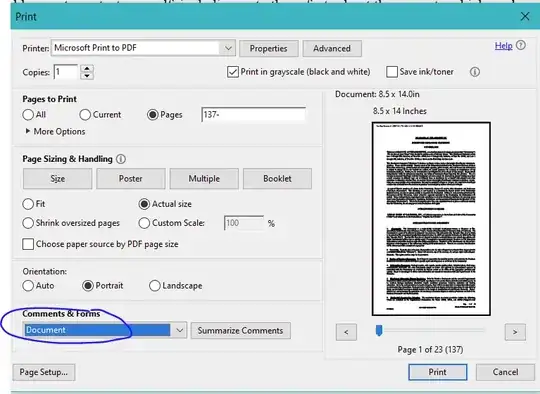

Big file reduction by just printing from Foxit Reader and using same Microsoft Print to PDF a little strange, but works for me.
  • Compare file size reduction:
  • From Acrobat PDF Reader (Bigger size)
Acrobat PDF Reader - Print with Microsoft Print to PDF
  • From Foxit PDF Reader (Small size)
Foxit PDF Reader - Print with Microsoft Print to PDF
