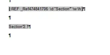

You can add a switch to the REF field that is inserted, in your case it would be \d "Section ". See screenshot below for example of the field (including the non-breaking space to keep the word Section with the number), as well as the resulting field.
Adding text to cross-reference field
