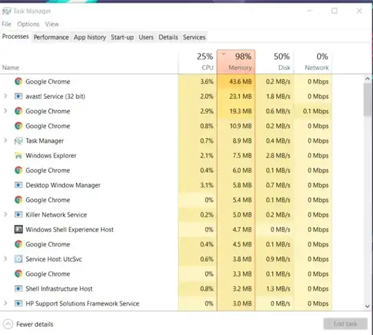

I've a problem recently with my PC. The RAM usage is always almost 100% no matter how many apps it's running. The problem appears these days and before nothing was wrong.
I'm using windows 10, my ram is the HyperX 8 GB 2133 MHz DDR4 (HX421C14FB/8) and my MOBO is the MSI Gaming M3 (MS-7978).
Task manager screenshots while only google chrome (to write this question) was open but it's the same when there is no app running:
Task1
Task2
Task3

    Your problem is the nonpaged pool usage. This is usually due to a buggy device driver. See magicandre1981's fine answer to see how to diagnose it here: http://superuser.com/a/674725/348119 Do post the screenshot of poolmon , and also post your etl file on a file sharing service so others can help (MA's answer explains how to use WPR to get the etl file). – Jamie Hanrahan Dec 10 '16 at 16:30
  • Looks like you have Killer Network Management installed. It has a reputation for memory leaks – David Marshall Dec 10 '16 at 16:42
  • Can you show the "details" tab in the task manager? – Sam Dec 10 '16 at 18:01
  • The "details" tab in Task Manager won't often help with pool leaks. – Jamie Hanrahan Dec 10 '16 at 19:27

The problem is the non-paged pool, usually caused by a driver issue. Typically it would be less than the paged pool.
