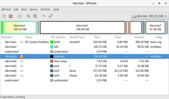

I don't know why my NTFS (/dev/sda3) partition is changed to "Unknown". I can't read this partition. My important files are located in there and I have to change it back to ntfs without losing data. enter image description here Any helps would be great appreciated.

I think this problem occurred since I reformatted /boot/efi partition in /dev/sda1
Safer approach is to try recover the data without changing anything on the 'patient'.
NTFS (or another file system) switching to unknown or RAW can be caused by several things, some times in-place repair is possible but it is always more risky than recovering the data by copying it to another drive.
  • To mount a partition's file system we need correct offset to boot block so if partition table points to wrong sector file system may be seen as RAW. This is potentially fixable provided boot sector and file system are intact.
  • Then boot block needs to be intact and point to file system structures correctly. This is potentially fixable provided the file system itself is intact.
  • The file system meta data itself needs to be intact. If partition table is pointing to correct location and boot block to MFT (as we're dealing with NTFS) but MFT is corrupt file system will be seen as RAW by Windows.
Partition sector doesn't have the endmark 0xAA55
Last two bytes in partition table and boot block should be 0x55AA or depending on direction in which you want to read 0xAA55. If they're not it's an indication the structure is corrupt although theoretically it could be just those two bytes I suppose.
Safer approach (vs. in situ repair)
Best solution IMO is recover data by copying to another drive. An example of an inexpensive tool that can be used for this is DMDE. In case file system meta data is slightly corrupted you may need to only select the partition and click 'open volume'.
