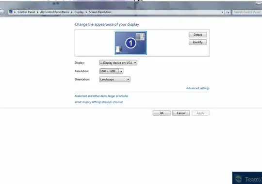

I've been trying to narrow down the issue, and by connecting to the PC via teamviewer and then turning the monitor off and on again, I can see the issue. When the monitor turns off, nothing happens - the screen resolution stays the same, and interestingly windows still reports the current display is UHD and my Asus PB279Q monitor even though it is off.
When I turn the monitor back on, it appears to disconnect and then reconnect. In the brief period while that is happening, windows returns to its "Display Device on: VGA" default screen:
Simulated Display
So far as I can tell this is the "screen" that the resolution can be controlled using the "SIMULATED_..." entries in regedit as mentioned in a couple of the answers of the linked question. To that end, I have tried changing the configuration to match my 4k monitor. Changing the entries has done something as the default is 1024x768. However it seems that Windows is limiting the values in those entries to 1600x1200.
If I disconnect the monitor entirely, it goes back to this default monitor, but it won't let me select any resolution greater than 1600x1200.

I had a similar Displayport problem on windows 7, with windows being resized and moved around after a sleep, and sometimes the monitor would not wake up at all unless I turned it off and unplugged the power first (only doing one of those things would not fix it).
I was able to fix this in my monitor's configuration settings by setting Displayport Hot-Plug Detection to "Always Active" (it was set by default to "Low Power"). This was an HP monitor, but if your ASUS has a similar setting to keep the Displayport active while asleep (rather than go into a low power mode), it might solve your problem. I also found on option to keep my USB ports on the monitor in a low power (rather than unpowered) state during sleep, which stopped the annoying 2-3 "USB device found" events I would get every time I woke my monitor back up.
