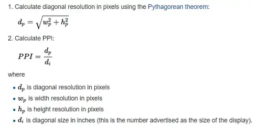

They can't, some parameters have been reported incorrectly. You can verify this yourself as follows.
There is a convenient pixel density calculator at this website. The calculation is trivial (from wikipedia)
Using this formula and/or the online calculator shows that for the X250 to have a ppi of 183 with a resolution of 1920x1080 it would need to be a 12" screen, not a 12.5" screen.
Using the value of 12" instead of 12.5" comes out to almost exactly 183 ppi while 12.5" comes to 176.
So either the manufacturer has redefined ppi, or they are not reporting the resolution or screen size accurately.

A 12.5" diagonal with an aspect ratio of 16:9 means a screen area of 66.8 in^2. So, the square-pixels-per-square-inch is (1920 pixels * 1080 pixels) / (66.8 in^2). Take the square root of that to get pixels-per-inch (PPI), and it's 176, just like the website shows.
The math for the X260's PPI looks correct given that it's missing the aspect ratio and probably just defaulting to the common 16:9.
PS - Wikipedia's equation for PPI, as cited in the currently accepted answer, is simply wrong. PPI is the square root of the number of pixels over the area in which they're displayed. This doesn't reduce to the expression given on Wikipedia.
