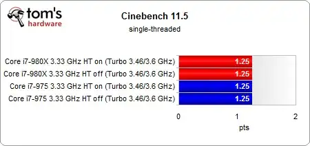

If we add another test from Tom's Hardware to compare it with the table you have shown (Cinebench R11.5):
And multi-threaded:
The results on single-thread performance are not so different from the ones that you have shown in your page. It is important to note that the two logical processors that have separate execution states share resources such as the system bus or cache so they can not always parallelize the tasks, and it can happens sometimes thread stalling mentioned in this article that means that in the single-thread stress test, the resource sharing could tend to enqueuing some threads delivering a slightly worse performance result.
