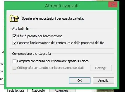

EDIT: As suggested by @Overmind I tried with a short cut, but it does not work; this is what I have in its Properties:
In Avanzate (read Advanced), I have:
Probably I should have written it before: I have an Home Edition, not a Pro.
