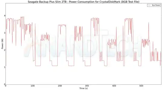

TL;DR
  • Seagate Backup Plus Portable 5 TB peak/idle power consumption: 4.2/1.4 W
  • Seagate Backup Plus Slim 2 TB peak/idle power consumption: 3.9/1.1 W
From Seagate Backup Plus Portable 5TB & Backup Plus Slim 2TB Review: SMR for the Consumer Market (Page 4)
I had purchased some NanoTech dual port USB 3.0 ExpressCards, and their quoted current rating is 900 mA per port. As I intend to use them with some 5 TB Seagate "portable" passport disks, I thought that I should check whether I needed a Y-splitter USB cable to provide the required current.
Graphical illustration of power consumption:
For the 5 TB Seagate Backup Plus Portable
Current consumption: 5 TB Seagate Backup Plus Portable
For the 2 TB Seagate Backup Plus Slim
Current consumption: 2 TB Seagate Backup Plus Slim
Note that the spin-up current probably isn't shown in the graphs, and is probably higher than the quoted peak value. Likely to be over 1 A as shown in stunpix's answer.
Graphs from Seagate Backup Plus Portable 5TB & Backup Plus Slim 2TB Review: SMR for the Consumer Market (Page 4).
Deriving the values for the peak/idle current from the power consumption gives:
  • 5 TB 840/280 mA
  • 2 TB 780/0.22 mA
So, just for spin up, to be ultra safe, it seems like a Y-splitter cable is required.
