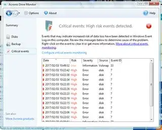

Bad sectors starting to show up:
Bad Sectors

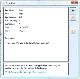

Upon clicking event details:
Event Detail
Health bar falling to 68%:
Health Bar
