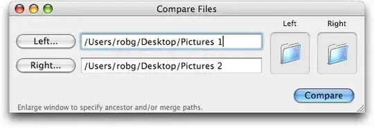

There were two "in the meantime" solutions here that I would just not call "simple"... Luckily I've stumbled upon it:
alt text
That's called FileMerge and can be found in /Developer/Application/Utilities when you install the Xcode developer tools from the Mac OSX CD or download it from apple.
It first compares the two folders you selected and then shows the differences. You can then select if you want to merge the files to one destination file.
Still not quite as simple as I suggested, but at least it must be the best "meanwhile" known option if you have about 1.5 GB free for the installation. The "cp" is hard to keep up and the server + Transmit won't let you do it unless it's local.
Now we just need a way to use it without installing Xcode... I'll edit later if I manage to do it - this seems like no simple mater after a lot of googling.
