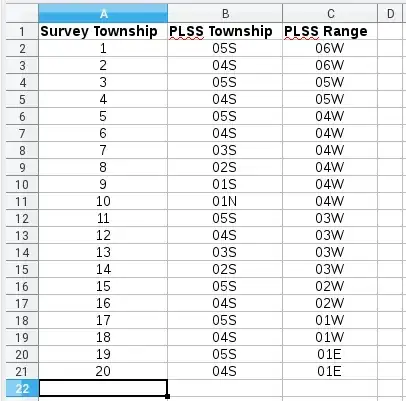

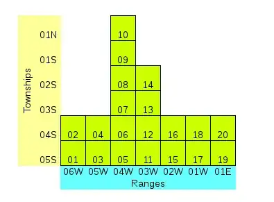

Reading the description again, looking for answers to my earlier questions, I have concluded that each survey township not only falls within the grid of a single township and range square in the PLSS, but that it also matches it, except for the nomenclature. Thus, all 9 sheets of survey township 02 correspond to the old 9 sheets of Township 04S Range 06W (or 06E). Since you said that the current county has 20 survey townships, I created a hypothetical "map" of the country, showing it overlay of 20 survey townships onto a PLSS grid. (Since you have the maps, and know the area, you can adjust my example to suit.) I made this hypothetical map cross both a baseline and a meridian so that you would see its application in that eventuality.
This is the "map" I used for the example.
Converting that map into data for your Sheet2 generates the following sheet:

The formula for cell E2 is =VLOOKUP(VALUE(B2),Sheet2!$A$2:$C$21,2), to find the value (numeric) of cell B2 in column A of Sheet2 and return the value of the 2nd column in the same row. Note, this is the one point to be carefull! The values in the indexing column of Sheet2 must be numbers, not text. So instead of "02" it's only 2. This is probably better, since when you type numbers Excel wants to store them as numbers, not text, unless you force the issue with quotes or explicit cell formatting.
The formula for cell F2 is =VLOOKUP(VALUE(B2),Sheet2!$A$2:$C$21,3), except that it's the third column, this works the same as the formula in cell E2.
