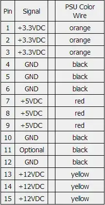

Here is a pin diagram of a SATA conector. Note the matching Molex wire color in the right-hand column: (Also note that Molex connectors do not provide a 3V line).
