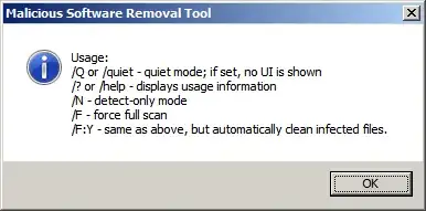

I tried which mrt ; system says which is not recognized. @DavidPostill probably meant mrt -version which shows the prompt in his answer, as with every other parameter... does it mean it's already installed, so the attempt of installing at startup is suspicious?

What do the /R and the /RE after the file mean to windows?
As explained in the other answers they are command line switches.
However the official Microsoft Malicious Software Removal Tool (mrt.exe) does not support these options (see below).
This implies that the version your system is trying to install may be malware.
See How can I remove malicious spyware, malware, adware, viruses, trojans or rootkits from my PC? for instructions on removing malware.
mrt command line options
WMSRT MRT.exe supports four command line switches listed below, which is optional and most of the time not necessary unless you’re administrator for corporate network:
  • /Q or /quiet – Use quiet mode. This option suppresses the user interface of the tool.
  • /? – Display a dialog box that lists the command-line switches.
  • /N – Run in detect-only mode. In this mode, malicious software will be reported to the user but will not be removed.
  • /F – Force an extended scan of the computer.
  • /F:Y – Force an extended scan of the computer and automatically clean any infections found.
Source How to Use Windows Malicious Software Removal Tool
> which mrt
C:\Windows\System32\MRT.exe
> mrt /?
Displays the following dialog:
