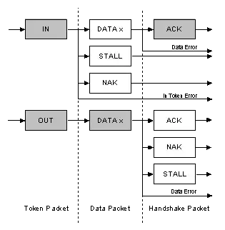

Any USB device regardless of its class requires bidirectional communication to function. Every USB device (or function in terms of USB spec) is represented as a set of endpoints which can be thought of as buffers which accept or receive data. However, even endpoints which can only send data wait for a special packet called token before they can reply: enter image description here
(image from here, gray boxes represent USB host, white boxes represent USB function)
Even so-called interrupt transfers are done in this way, with USB host polling connected devices using token packets. What differs between regular (bulk) transfers and interrupt transfers is that polling time is small and guaranteed in the latter case. Still, all transfers are initiated by the host.
