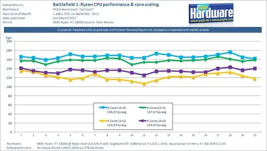

German reviewer PC Games Hardware tested a Ryzen 7 1800X with varying numbers of cores disabled and found that having two CCXs with two cores enabled on each produces slower performance than having one CCX enabled with all of its cores intact:
PC Games Hardware benchmark result: Battlefield 1
This is despite the fact that having only one CCX enabled means that only 8 MB of L3 cache is available, rather than the full 16 MB. From the PC Games Hardware article, via Google Translate (emphasis added):
