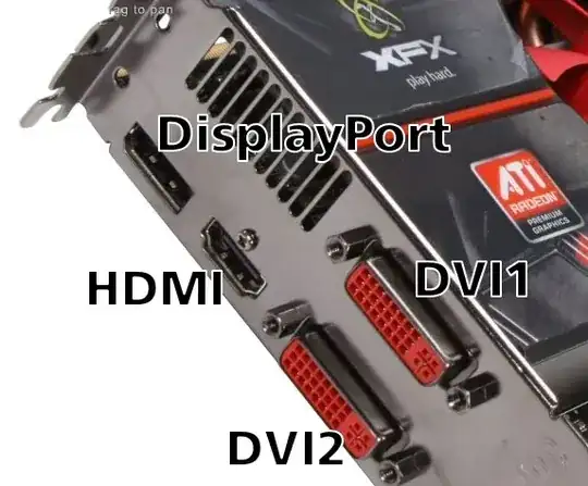

Newer Radeon video cards come with four ports standard:
  • DVI (x2)
  • HDMI
  • DisplayPort
If I want to run three 24" monitors, all of which are DVI only, from this video card -- is it possible to convert either the HDMI or DisplayPort to DVI? If so, how? And which one is easier/cheaper to convert?
I did a little research and it looks like there isn't a simple "dongle" method. I found this DisplayPort to DVI-D Dual Link Adapter but it's $120; almost cheaper to buy a new monitor that supports HDMI or DisplayPort inputs at that point!
There's also a HDMI to DVI-D adapter at Monoprice but I'm not sure it will work, either.
AnandTech seems to imply that you do need the DisplayPort-to-DVI:
The only catch to this specific port layout is that the card still only has enough TMDS transmitters for two ports. So you can use 2x DVI or 1x DVI + HDMI, but not 2x DVI + HDMI. For 3 DVI-derived ports, you will need an active DisplayPort-to-DVI adapter.

  • So although HDMI is pin compatible w/ DVI the card itself can only drive two of the single HDMI and dual DVI ports at a time? That stinks! I trust Monoprice on their cable and hardwares. How about instead of buying another monitor you add another video card? Depends what you are doing w/ the third monitor... – mindless.panda Mar 12 '10 at 02:50
  • Dell Optiplex 960 has the same problem - two TDMS drivers, but three ports. Only two will work at the same time. – staticsan Mar 25 '10 at 00:04
  • Or, instead of paying more money for an adapter, you could just buy another video card card (old school PCI even) for cheaper – Allen Apr 07 '10 at 20:54
  • OK, so the card can only power two digital outputs at once. Are there any consumer cards out there (mainstream-ish, not like $500+) that support 3 or more at once, without sapping USB power? – Coderer Apr 27 '10 at 17:09
  • @coderer it supports 3 digital outputs, it's just that 2 of them have to be DVI and one has to be DisplayPort. – Jeff Atwood Apr 28 '10 at 08:36

  • looks like you're right, active conversion from DisplayPort to DVI is the only way to get this to work -- I found [another active DisplayPort to DVI-D adapter](http://www.amazon.com/Accell-UltraAV-B087B-002B-DisplayPort-Dual-Link/dp/B002ISVI3U) with favorable reviews on Amazon. – Jeff Atwood Mar 12 '10 at 01:51
Yeah, the way the Radeon hardware works, is that one display circuitry drives both the DVI2 and the HDMI port. So you can't have them both hooked up at the same time. Therefore to get 3 monitors, you have to do DVI+DVI+DisplayPort, or DVI+HDMI+DisplayPort. DVI+DVI+HDMI is unfortunately NOT an option.
I believe the DisplayPort to VGA adaptors for ~$20 should work, if you can live with an analog signal on your 3rd monitor that's limited to 1920x1080 or 1920x1200 (most monitors are this size or smaller anyway still). The reviews on monoprice show it worked for 3 people with this card, but did not work for one person with this card.
