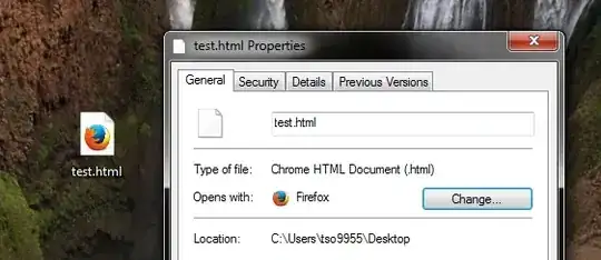

The problem is pretty straightforward. When I set an .html file to open with Chrome, the thumbnail icon is broken and doesn't show the Chrome logo.
I already tried deleting the IconCache.db file and then restarting my computer. Sadly, that didn't fix anything.
It works perfectly fine when I set the default program to IE or Firefox. Any idea on how to fix this issue?
enter image description here enter image description here enter image description here

  • Does this affect both Chrome 32-bit and Chrome 64-bit? (If you haven't tried the other one, but you're using 64-bit Windows, then give it a shot.) How about Chromium/Canary? If you change icon sizes (small icons / large icons), does that have an impact? – TOOGAM Apr 10 '17 at 05:37
  • @TOOGAM the same thing happens on 32-bit and 64-bit. – DrZoo Apr 10 '17 at 15:31
  • Interesting. The dragged shortcut that contains `html://...` is recognized by Windows as Chrome, but not the one that points to a local html file. Check the value of the registry key `HKEY_CURRENT_USER\SOFTWARE\Microsoft\Windows\Shell\Associations\UrlAssociations\http\UserChoice`, if `Progid` contains `ChromeHTML`. – harrymc Apr 10 '17 at 15:36
  • @harrymc Progid contains `ChromeHTML` at that registry location. – DrZoo Apr 10 '17 at 15:40
  • I think that the problem is that the file is stored on the desktop itself. Try to put it in some folder, say`C:\Temp`, and to create a shortcut to it. – harrymc Apr 10 '17 at 15:50
  • @harrymc the shortcut method also has a broken thumbnail. In fact, the thumbnail icon is broken all over the place :( It doesn't even show up right in Windows Explorer. – DrZoo Apr 10 '17 at 15:59
  • If you are on Windows 10, rebuilding the icon cache is described in [this link](https://www.howtogeek.com/232779/how-to-rebuild-a-broken-icon-cache-in-windows-10/). – harrymc Apr 10 '17 at 16:09
  • @harrymc I'm on Windows 7, but I tried that same method. The only difference was the file names. I'm about to say screw it :) – DrZoo Apr 10 '17 at 16:16
  • I sort of agree : The problem is trivial and more manipulation may cause more serious problems than the one you have. – harrymc Apr 10 '17 at 16:41
