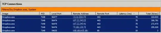

Although Dropbox is using other services, they have historically been using Amazon AWS (Amazon Web Services). It sounds like your transfer from the source to destination has a very big transfer pipe. In my experience, Dropbox is using a destination that can accept large amounts of data at once. Dropbox also distributes the upload to different IP addresses. The site you are FTPing to likely has a much smaller transfer pipe and does not have the ability to distribute uploads as efficiently.
If you run Resource Monitor (resmon), and go to the Network tab, you will notice the different processes using the network bandwidth.
  • Under Processes with network Activity, select the column for Total (B/sec)
  • Under TCP Connections, select the column for Total (B/sec)
For me, when I am uploading a file to Dropbox, it is using 4 connections to send 4 different IP addresses.
