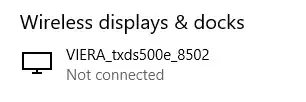

What I could do:
  • Correctly connected smart tv to Internet;
  • Could connect android devices with smart tv;
  • Establish a connection between laptop and tv;

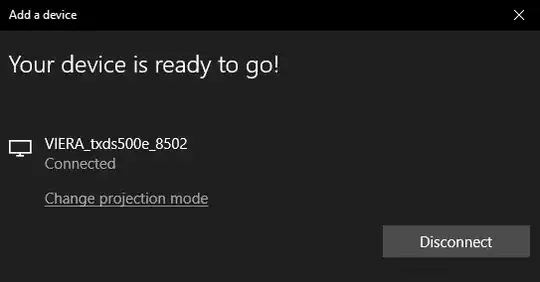

When it establishes a connection between laptop and smart tv first appears this image:
First information
but then my tv says that service is paired off and follow image appears on laptopfinal screen
Is this a problem from my Tv model or windows 10?

  • Did you try changing display right after you connect? There should be a button which changes display mode (extended, double, etc.) –  Apr 30 '17 at 17:04
  • Yes, I tried. The problem is that immediatly after that TV disconnects – Goldbones Apr 30 '17 at 17:08
  • Have you checked that you are using the latest firmware from Panasonic on the TV, as well as the latest drivers & firmware from your WiFi card manufacture on your WiFi card? I had similar issues with a Samsung and it got better (4-5 min) with firmware on the TV and then worked right after upgrading the laptop (OS patches and all the newest drivers from Intel for my Intel WiFi) – Ruscal May 04 '17 at 00:30
