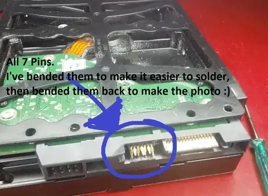

I tried to clean my computer and accidentally ripped of the SATA cable from the HDD which resulted in a broken SATA data port because the "L" on the HDD broke off and was stuck in the cable. I wanted to replace my HDD anyway since it is very old and I have backups but a very few new things (like some unused web designs or some documentations) are not saved yet and I'd like to try to save them. (But its not suuuuuper important.) I'm aware of the fact that this HDD will not be good for actual use anymore, so after saving the files it will get replaced immediately.
On the HDD are (luckily) all 7 pins looking out (no pins have broken off) and I casually tried to solder it, as I solder everything quite sucessfully when some of my parts get broken, but I noticed that the cable has 8 instead of 7 pins...
Here some pictures:
(8 Pins ???) This is the cable with both sides (1 side stripped off to solder it)
(7 Pins) This is the HDD with the broken SATA data connector
I googled and I find that the SATA Data cable indeed needs only 7 pins, so now I'm wondering how I can find out which one I have to solder and which one has to stay unsoldered. Are the pins on the cable even in the right order? (For example: the rightmost pin from the cable goes to the rightmost pin of the HDD SATA data connection)

    Stop bending them! (You have used up 2 of about 6 bendings available.) – AndreKR May 08 '17 at 03:53
    You might be better of getting a new PCB from eBay. It has to be the same make, model and revision. – Daniel B May 08 '17 at 08:00
    You have not *bended* them, you have *bent* them :) – Hanky Panky May 08 '17 at 08:43
    Thanks @HankyPanky, you seem like someone who shares very useful tips to this Community :) – Milos May 08 '17 at 08:44
  • @Daniel B make this an answer, since it is a very viable solution to the problem. – rackandboneman May 08 '17 at 09:04
  • Look at Journeyman's answer for the SATA pinout... The cable you have is composed by two "emi"-cables. One has the A+/A- couple and two grounds, the other has the B+/B- couple and two grounds. Usually the two innermost grounds are tied together, so no wires are left unconnected. You can just try, but I think that your pins will break easily.. Better solder on the pads on the PCB – frarugi87 May 08 '17 at 10:36
  • I'd pull the drive from what looks like a cradle in your photo and try to solder to the PCB contacts behind the smashed connector. – John U May 08 '17 at 12:58
    Just toss the disk in the trash. You've got backups, right? Oh... – Roger Lipscombe May 08 '17 at 14:31
  • When this happened to me last year, I was still able to hard slide the pins into the SATA cable. I then strategically just super glued and hot glued the cable. It worked well enough that I was able to clone the drive to another. Could still possibly go that route. – TyCobb May 08 '17 at 20:30
  • I think you will have the best luck taking the whole interface assembly from a donor drive and unsoldering them both from their PCBs, then resoldering the complete one to the PCB you want to repair. With a solder wick you should be able to do it and maintain the intregrity of the connectors. – PhasedOut May 08 '17 at 22:12

Actually, there's only 4 pins that matter
image of pinout of sata plug
You have 4 wires for signal, 2 per 'channel' and 3 grounds (which should be tied together anyway). The 4 bare wires on the outside of each pair/channel are ground, and any three should work.
You absolutely do not want to do this without a multimeter.
That said, I strongly recommend plugging one end into a switched off PC or drive and checking continuity between all 4 ground wires (on the outside) and checking each pin and its corresponding wire to ensure you know which wire is which. If you don't have a multimeter, you ought to get one and learn the basics of using it - continuity testing is about the simplest function in one.
I'm also not sure if trace lengths matter here, and that may be an issue. Not sure how to deal with that considering everything I've seen in the question though

Don't try to strip and solder a SATA cable. It's unlikely to work; the wires have some really touchy electrical properties.
Instead, flatten the contacts back out, get a fresh SATA cable and carefully line the bare copper contacts from the hard drive up with the contacts in the cable. If you apply pressure in the right way, you should be able to establish a connection long enough to recover your data.
    "the wires have some really touchy electrical properties." - Could you please explain this further? Because I already stripped them and soldered it but the HDD doesnt seem to get recognised by my system even tho I triple checked every connection and re-soldered it. Im not an electrical engineer (but I have all the equipment) but I cant see what the problem should be when wiring them with normal wires? Thanks a lot :) – Milos May 08 '17 at 08:18
    @Milos its things inherent to all high-speed data buses, but I think one of the major things here will be that special measures are taken to ensure all data lines are of exact equal length, just cutting, stripping and soldering the cables individually will almost definitely have violated this and made the connection unlikely to work. – James T May 08 '17 at 08:55
    @JamesTrotter: With SATA 3.2 we talk about ~2cm wavelengths so anything up to 2mm mismatch can work and anything with .5mm is basically guaranteed to work. Multiply those numbers by 10 for SATA 1. The most likely reason this won't work is that at the point where things are soldered you have a gross impedance mismatch. SATA Plugs are actually manufactures to stay within the specified impedance. – PlasmaHH May 08 '17 at 11:45
    I can endorse this recommendation. I was able to recover from a similar mishap with an SSD this way a few years ago by carefully reinserting the cable with the broken stub of the device connector back into place and securing it with tape. – Dan Is Fiddling By Firelight May 08 '17 at 13:53
    This is a great answer. As @PlasmaHH mentions, SATA 1 would probably be (slightly) more tolerant to impedance mismatches, so it might be worth investigating if there is a way to select that in your BIOS, or if you have an older SATA expansion card that only does 1.5 Gbit/s. – pipe May 09 '17 at 15:34

Instead of trying to fix it, you could also try and get a new PCB for the disk. They are very easy to swap. You can look on eBay for replacements, for example drives with mechanical failure.
However, for best results, the PCB needs to come from an equal device:
  • Same make
  • Same model
  • Same hardware revision
Most of the drive’s firmware is actually stored on the disk, so the firmware version isn’t that important.
/edit: However, it appears there is some unique calibration data that is required for most modern hard drives to function properly. It is unique to each unit. There are PCB replacement services that offer to transfer the data for you.

    For many hard drives, this absolutely won't work because the calibration table is stored on the PCB. – David Schwartz May 08 '17 at 17:02
  • @DavidSchwartz Thanks for the warning! Could you help me verifying if it is possible to replace the PCB on my HDD? The PCB Board I would need is 2060-771824-008 for the HDD WD10EZRX from Western Digital (http://www.hddzone.com/wd-2060771824008-pcb-p-477.html) Thanks in advance :) – Milos May 09 '17 at 08:32
    @DavidSchwartz PCB replacing is a common last-effort data recovery technique for drives that don't spin anymore (before sending it off to a real recovery company with clean rooms, etc...). I usually tried to match everything on the PCB's, even down to the year the drives were made or even closer if possible. Firmware versions matter, along with everything else. I've done this a handful of times, and sometimes it works sometimes it doesn't. – SnakeDoc May 09 '17 at 18:25
Exact length of all conductors is not as important with serial-lane buses like SATA or PCI-E, compared to eg parallel SCSI. But keeping both wires of each differential pair same length, not separating the wires from each other and associated shields more than necessary for more length than necessary is essential. https://sata-io.org/system/files/member-downloads/SATA-6gbs-equipment-design-and-development-finisar.pdf suggests specs like 4.5GHz(!!!), 50-100ps risetime(!!) on a sata cable. Whether the actual base frequency of the signal is 4.5Ghz is near irrelevant - if the modulation scheme needs bandwidth to that degree, it needs it. The wavelength of a 4.5GHz signal on a common cable will be 4 to 5 centimeters.
A common rule of thumb in working with AC signals is that a wire longer than 1/10th of the wavelength (this would be 4mm here) can no longer be treated as "just a wire", since the same effects that will make "just a wire" suddenly act as a coil, antenna, or capacitor plate (none of which you have any good use for here) will start to predominate over "just a wire" behaviour.
For example, a an extra quarter-wavelength (about half an inch at 4.5Ghz) piece of cable with nothing connected to the other end, soldered in parallel to the signal wires, would be expected to be just an open circuit. Far from it. This will behave as a dead short if nothing is connected to it, and behave as an open circuit if the end is shorted.

    I would say that the length matching is doable rather easy, the impedance mismatch at the solder point when soldering bare wires to the broken connector is what will destroy the signal. Removing that broken connector and soldering the wires directly onto the pcb has the highest chances of success, I would expect the link training to compensate for the rest. – PlasmaHH May 08 '17 at 11:50
  • Absolutely. Or getting a shape compatible connector from another scrap harddrive and soldering it in. – rackandboneman May 08 '17 at 11:54
  • You can just buy the connectors. -- They're cheap. – BrainSlugs83 May 10 '17 at 00:00
I did it once, on a homebrew hack-it-all frenzy on an old (~2010 maybe?) toshiba laptop motherboard towards the original SATA disk.
And it worked, and surprisingly well too. I made sure I soldered only ONE ground pin, because I was using an USB2 shielded cable and wanted to avoid ground loops (I would have had to join the 3 grounds on the same shield, and that would create 3 mini loops).
Other than that, even if it works, use an external USB-to-SATA converter to avoid frying your motherboard and, after you recovered any precious data on the HDD, throw it away (or replace its controller board like others said).
