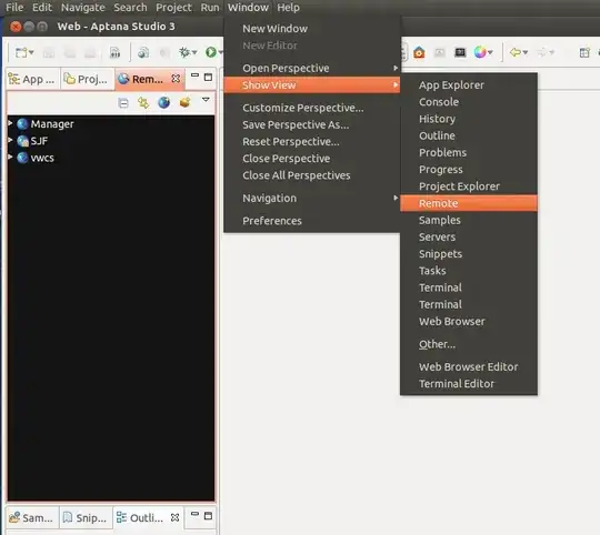

I don't know why Aptana made it impossible to find, but here is your answer.
  1. Cick 'Window', from top navigation
  2. Click 'Show View' -> Remote
  3. You will see a remote tab next to App explorer.
  4. Right click on an of the connection and select 'Properties'.
  5. You can also delete the connections from this view.

You can modify the connection from your File View. To change the connection, right-click the connection and select Properties from the context menu.
Here you can change anything you would need to change.

You can remove/view/edit the connection by going to Window -> Show View -> Remote
