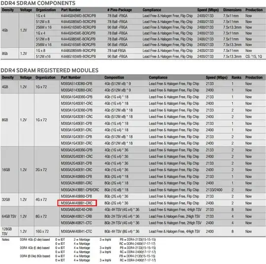

Then I searched for the part number M393A4K40BB1-CRC and found the Samsung Production Selection Guide. It says this for this part number:
And I found the datasheet. It says this: enter image description here
So it basically says the DDR4 module M393A4K40BB1-CRC is made of DDR4 SDRAM component K4A8G045WB-BC##. And as I checked the pyhsical DIMM, it is indeed that componnet. But I simply cannot find this K4A8G045WB-BC## component in the previous componnet table. I think this is a doc error.
But anyway, what I really care about is how to derive the bank, row, column info from this sheet?
And how to interpret below parameters from the datasheet?
From the Component table:
  • 1G x 8
From the Module table:
  • 4G x 72
  • 8Gb(2Gx4)*36
It seems x and * have different meanings. What's the difference?
