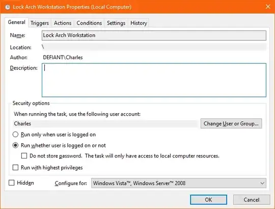

Follow the below steps to troubleshoot and resolve your problem
Task Scheduler Properties. . .
From Windows Task Scheduler on the job properties (see bottom most screen shots) in the. . .
  • 1. General tab, ensure that the below options are select/checked or unchecked just as shown in Print Screen A
    • Uncheck Run only when user is logged on
    • Check Run whether user is logged on or not
    • Check Run with the highest privileges
  • 2. Conditions tab, ensure that the below options are select, checked, or unchecked just as shown in Print Screen B
    • Check Wake the computer to run this task
  • 3. Actions tab, click Edit, and enure that the Start in (optional) is set just as shown in the below example (DO NOT put double quote marks around it) for the full path pointing where the batch script is located WITHOUT a final backslash "\" Print Screen C

From there, you can set up triggers to the 4800 (lock) and 4801 (unlock) events like so:
Trigger configuration

    Thank you - this is the first place I've seen simple, concise instructions on how to enable logging of workstation locking – Omegacron Apr 20 '18 at 21:38
The Win10 task scheduler has a lot of bugs -- especially in the GUI. See: https://www.ctrl.blog/entry/idle-task-scheduler-powershell
You might have some luck re-compiling the interface:
mofcomp c:\Windows\System32\wbem\SchedProv.mof
You may also want to create the task via COM interface in PowerShell. I prefer using a string variable containing the XML definition. You can export the XML of the GUI-created task and clean it up/correct it. Then:
$TaskService = new-object -ComObject('Schedule.Service')
$TaskService.connect()
$Task = $TaskService.NewTask($null)
$task.XmlText = $XMLstring
$null = $Global:TaskFolder.RegisterTaskDefinition('Lock Arch Workstation', $Task, 6, $null, $null, 3)
Good luck!
