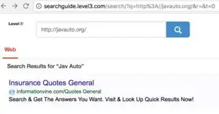

Each time when I type some non-existing domain name in Chrome bar address, I'm redirected to Level3 Search engine.
For example when going to: http://javauto.org, I'm getting the immediate redirect to: http://searchguide.level3.com/search/?q=http%3A//javauto.org/&r=&t=0 with some ads and meaningless results.
I don't know how this got installed. I don't have any Level3 extensions and I use DuckDuckGo as my default search engine.
How can I remove this Level3 search engine from Chrome? As this is very annoying.
Level3 Search Guide in Chrome

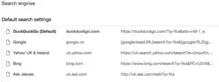

To clarify, my default search engine is set to DuckDuckGo:
Chrome, Search, Set which search engine is used when searching from the omnibox
And Level3 doesn't exist on the main search settings list, either on Other search engines list.
Search engines, settings, DuckDuckGo

  • go to _Settings_ -> _Manage Search Engines_ (in the search sector) and tell me what you see in the _Default search settings_ – Jimmy_A Jun 02 '17 at 13:24
  • @D.A It's DuckDuckGo – kenorb Jun 02 '17 at 13:25
  • Click on the manage search engines... Can you see there the searchguide.level3? – Jimmy_A Jun 02 '17 at 13:26
  • @D.A No, it's not even on the list. – kenorb Jun 02 '17 at 13:27
  • what about in the other search engines in the same pop up – Jimmy_A Jun 02 '17 at 13:28
  • I've posted the screenshot. It's not on _Other search engines_ list either. – kenorb Jun 02 '17 at 13:29
    "Searchguide.level3.com (aka Searchguide Level 3) is a DNS modifying browser hijacker application which intercept web traffic and causes certain browser redirects to other websites. " – DavidPostill Jun 02 '17 at 13:29
