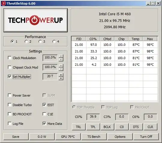

  1. Download and install throttlestop
  2. Press the button which says c0, it is probably c7 on your pc.
  3. Set the limit to c0
