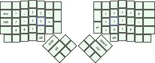

I use a keyboard layout called 3l (three layout) which is a layered keyboard layout. Here is the main layer (the behaviour when no modifier keys are pressed):
normal 3l layout
Now, when I am holding down the ' on a normal keyboard (sym in 3l), I am in "symbols" mode and the rest of the keyboard behaves differently. Here's a picture of this mode:
symbols layer of 3l
Effectively, this symbols key is like a special Shift which allows me to access special characters.
Additionally, I have a numbers layer which has the same effect as the symbols layer and is activated by the / key, but has cursor and number-pad controls instead:
The person I forked my layout from already got the layout working in Linux and Windows (using AutoHotKey). I am trying to port it to macOS as well. So far I have created a 3l.keylayout file (see it here) and have very basic functionality working.
