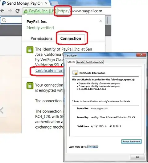

Before somewhere around Chrome 55, I could look at the details of a certificate a website is using by clicking on the Green lock icon:
Now that functionality seems to be gone; see picture below:
How can I bring this back? I know I can go into Developer Console -> Security but it's a tad impossible:
I want to know that i'm seeing the correct certificate (e.g. issuing authority, SHA-1 fingerprint); and that someone isn't attempting to intercept my communications.

As of Chrome 60 it is possible to return certificate details under "lock" menu. This option has to be enabled manually by accessing chrome://flags/#show-cert-link.
When you enable it and restart the Chrome, option to view certificate will be visible when you click on lock icon.
