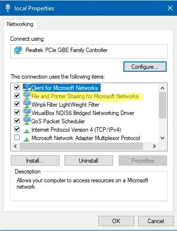

UPD. Network adapter properties shows that "File and Printer Sharing" is enabled.
network adapter properties
Just to be clear, again, 192.168.1.2 is address of my computer from which I try to access my own file share and it does not work. Here is the routes table.

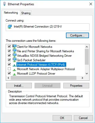

The only difference I see from my PC compared to yours, from what you have shared, is the NETBIOS over Tcpip. Mine shows enabled, while yours is showing disabled, so that should be an easy enough setting to see if it fixes your problem.
From the Ethernet Adapter Properties window, double click the Internet Protocol Version 4 (TCP/IPv4) to bring up the IPv4 Properties windows.
Select the "Advanced" button.
Then choose the WINS tab, and enable the NetBIOS setting. Mine is at default, so choose to enable it if it's set to default.
Restart the computer and see if it worked.

    This didn't work for me. Despite NetBIOS over TCP/IP being enabled in the dialog box, it still showed Disabled in `ipconfig` (same result by selecting "Default" in dialog box too). – I say Reinstate Monica Feb 18 '18 at 05:14
  • For me, although NetBIOS over TCP/IP showed as enabled in the dialog box, I decided to disable it, reboot, then enable, and reboot again. This solved the problem for me. – Mike Jan 09 '23 at 10:57
  • The IP address 192.168.1.2 is assigned by DHCP on 192.168.1.1, then DHCP should provide NetBios settings.
  • I think if you use static IP address you will be able to enable NetBios.
  • Disable IPV6, IPV6 does not support NetBios: NetBIOS name resolution is not supported by Microsoft for Internet Protocol Version 6 (IPv6). https://en.wikipedia.org/wiki/NetBIOS
  • Try to create a workgroup and make the computers members of the workgroup, then create the share.
  • Check ports used by NetBios on Router:
  • UDP port 137
  • UDP port 138
  • TCP port 139
