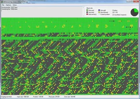

Here is a ddrescueview map of the first recovery:
ddrescueview 1st attempt NTFS partition
There's an interesting pattern, with stripes of easily recovered data alternating with very slow or unreadable data. [From what I know, it would seem to indicate that a head came in contact with a platter, damaging the surface and releasing magnetic dust, which then spread with the centrifugal force. And since the servo track (which contains essential information for the startup process) is located at the outer edge of the hard drive (it's a 3.5" Hitachi 1 TB), some of that dust may have reached it, making it difficult to access, which could explain the frequent clicking noises at startup.] (Correct me if I'm wrong.) => [EDIT 20200501] Thas was wrong, actually this pattern typically indicates that one head of the drive has completely failed and is no longer reading anything, the data on the platters may be still readable at this point but it would require the replacement of the head stack assembly, which only a specialized data recovery lab can safely perform.

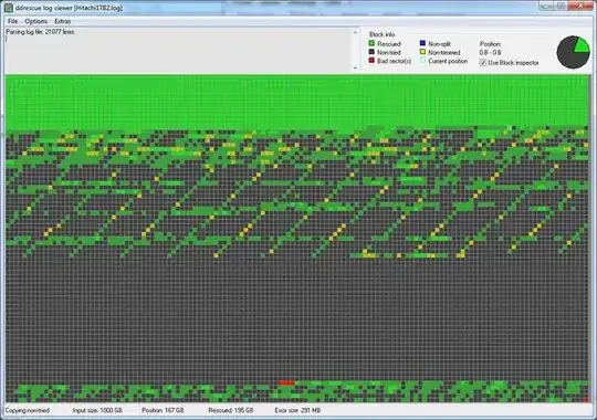

Here is a ddrescueview map of the second recovery:
ddrescueview 2nd attempt Ext4 partition
So the hard drive became very unstable and the recovery increasingly difficult after about 165 GB, but before that the copying rate was consistently high, with no skipped areas. I later used the ddru_ntfsbitmap method, for the last attempts, so the unallocated space was mostly skipped.

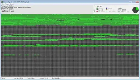

Here is a ddrescueview map of the log file created with ddru_ntfsbitmap, showing the areas of the hard drive containing actual data in green, and free space in grey:
ddrescueview ddru_ntfsbitmap log file
Luckily, most of the actual data was located in the first quarter and was successfully recovered. Now I have yet to combine the good parts of those two images, and extract the actual files, probably with R-Studio (best data recovery software that I have tried).

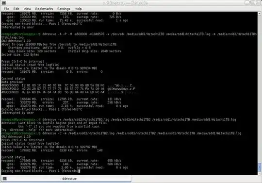

One thing I later found out which is interesting and peculiar, regarding my initial question (I guess I should have put this as a comment, as per the formal rules, but it would have been too long and I couldn't have provided screenshots).
I attempted to copy the rescued areas of image 2, on the Ext4 partition, which were missing in image 1, to that image 1, on the NTFS partition{1}, which should have been done at a very high rate (input and output being on a healthy 2 TB HDD), yet I got an average speed of only 660 KB/s, thus very close to the speed of the initial recovery at a later stage when I got concerned enough to ask this question in the first place...
Command used (log file for image 2 used as a domain logfile) :
ddrescue -m [image2.log] [image2] [image1] [image1.log]
Screenshot:
ddrescue copy rescued areas image 2 to image 1

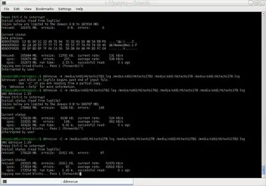

So I stopped and did the opposite : I copied the rescued areas in image 1 (NTFS) which were missing in image 2 (Ext4), to that image 2 — and now the copying rate was about 43000 KB/s or 43 MB/s on average (maybe slightly slower than what should be expected for a copy on the same HDD, for a Seagate 2 TB which has a max write speed close to 200 MB/s, so should be able to reach about 100 MB/s for a copy from one partition to the other, but still almost 100× better than the first attempt). What would be the explanation for such a tremendous discrepancy?
Command used (log file for image 1 used as a domain logfile) :
ddrescue -m [image1.log] [image1] [image2] [image2.log]
Screenshot:
ddrescue copy rescued areas image 1 to image 2
