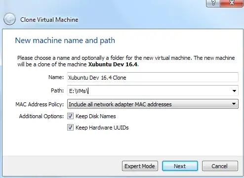

I don't know if this is best way, but it's the fastest way, and only if you want to discard all snapshot and leave current state.
Go to snapshots, right click on current state, click clone, and select all checkboxes and set "Include all network adapter..."
On the next screen select "Full Clone"
On the next screen select "Current Machine State" and hit Clone
Now you have exactly same machine without any snapshots. Need to delete old machine
Cons: - need to either rename old VM before clone or new VM after clone. Since you are preserving all UUIDs all should work same including command line automation. - need additional space to make double size temporarily
Pros: - Fast Auto merge of all snapshots, so no need to waste time to delete one by one
Pawel Cioch
  • 121
  • The question says “I can't clone or export the VM because it's already using 75% of the host disk.” – Scott - Слава Україні May 23 '19 at 23:01
    Didn't read carefully :) but technically if you specify a clone to a different HDD that has enough space it should work. You really can't clone or delete snapshots on same HDD as either approach need x2 space to really copy entire data. You could try delete one by one staring with smallest, hoping to release space for biggest but you likely end-up stuck at some point. You just need more space. Maybe move VM to other external HDD/SSD merge on other Host, move back? – Pawel Cioch May 24 '19 at 18:38
