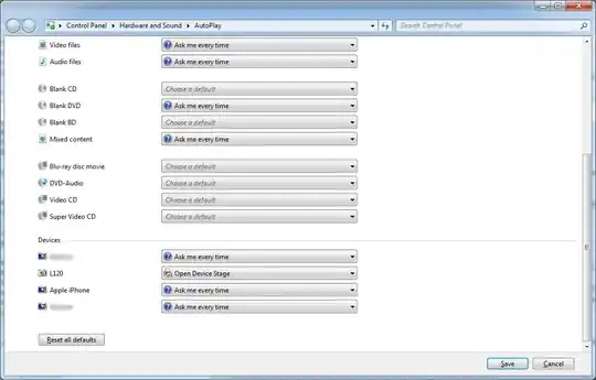

Infuriatingly, not only does MediaMonkey make itself the default Autoplay application for your device, it also reaffirms this setting each time you plug your device in, effectively riding roughshod over the user right to control how your device connects to your computer. In addition, I couldn't find any option in MediaMonkey's own settings to disable this behaviour.
After changing and saving the option in the Control Panel:
Immediately after reconnecting the device:
