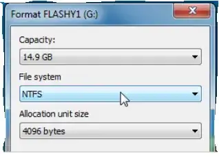

Also you could right click f drive in File Explorer and choose the format option to check if it works fine. enter image description here
Please note: back up important data first.

  • Ended up formatting in file explorer. Was trying to avoid that, because didn't want to lose data (the command prompt should have converted without losing data), but it wouldn't work any other way – SteveM Sep 13 '17 at 23:49
