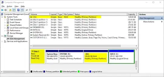

However, since I placed a bounty, I also researched anew if there was a solution. I ended up on the excellent reboot.pro forum in this thread and from there found a mentioning of Arsenal Image Mounter. Apparently written, in large parts, by Olof Lagerkvist of LTR Data (creator of ImDisk), Arsenal Image Mounter includes a storport driver, which is exactly the thing I was looking for.
The steps were:
  1. Installing the driver
  2. ... and using ArsenalImageMounter.exe from an older revision
... allowed to attach the VMDK file as a SCSI disk to Windows. This also caused the volumes to be auto-mounted (much like is done when you attach a partitioned USB disk), but the important part was that the volume was now visible to VeraCrypt for mounting.
This satisfies the requirements I put up in my question.
The steps in screenshots looked as follows (after installing the Arsenal Image Mounter driver):
Options before the disk gets attached
(Terminology here is also a bit fuzzy, because this tool apparently provides both attaching an image file as SCSI disk and mounting volumes therein.)
Image file attached as SCSI disk
And the result in the disk management snap-in of Windows 10 looks like this:
Windows 10 disk management
The relevant parts are that Disk 3 is the (VMDK) image file appearing as actual disk to the system and VeraCrypt is able to see that RAW volume which had been automatically assigned the drive letter H: (and subsequently opened up the dialog to format said volume). The relevant parts are highlighted in the last screenshot.
