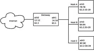

A basic diagrammatic example of what I'm thinking off: enter image description here

  • Thanks, that makes things a bit more clear. One of the reason I wanted to add a switch was to reduce the load on Asus router. At the moment, I can comfortably stream videos from Plex to 2 devices. But if I try more then that, it starts lagging. As I will be adding the rack, is there anything I can do to help with this? – Zac Oct 04 '17 at 13:14
  • Are those 2 devices both connected over Wi-Fi? – u1686_grawity Oct 04 '17 at 13:17
  • No. TV has a network cable connection and laptops/mobile devices are through wifi. I am planning to have a network port in all the rooms so that all laptops/stand alone PC's in the house are connected via a network cable. Only mobile devices will be on wifi. I've added a high level diagram, hopefully to make things a bit more clearer as to what I want to achieve – Zac Oct 04 '17 at 13:20
  • Well, for Wi-Fi devices i'd say get more access points (and put them on different channels), but that's more of a separate question really. – u1686_grawity Oct 04 '17 at 13:28
  • Maybe something for the future :). Thanks for your input – Zac Oct 04 '17 at 13:31
