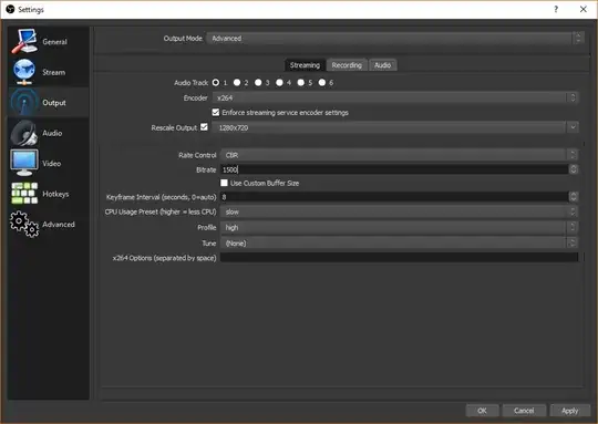

I am trying to stream an FPS shooter game from OBS 20.0.1 at the lowest bitrate possible whilst maintaining the best quality possible (i.e. less blocky pixels).
I am concerned that more reference-frames will increase my bitrate. So since this is high-motion streaming, should I use -tune animation to boost deblocking? Or would PSNR or SSIM be more promising candidates?
Is there any better/other way to test which -tune-option is best than trying them with test-streams?
Also, are there any other x264-options that my stream would benefit from, but which are not included in OBS?
My OBS setup: OBS Setup

  • your link is broken. why not put the code into the question? also, have you read through [FFmpeg's Streaming Guide](https://trac.ffmpeg.org/wiki/StreamingGuide)? – flolilo Oct 11 '17 at 10:51
  • also, read through [this post about x264's tune-modes](https://superuser.com/questions/564402/explanation-of-x264-tune/564404#564404). – flolilo Oct 11 '17 at 10:59
  • FFmpegs streaming guide only says use -zero latency and the x264 tune-modes post isnt in depth enough for me to make an informed decision, but If i had to guess the best I'd go with Animation from reading the post – Trr1ppy Oct 11 '17 at 12:32
  • Not trying to be rude, but since you're talking about the holy grail (**fast** encoder that needs only a **small bitrate** for **visually superior** results), I don't think that you understand the importance (or the lack of it) of the `-tune`-parameter in x264. If using `-tune PSNR` would lead to better results with less bitrate in less time, then I'd think that everyone would use (and promote) it, especially since we are talking about an open source tool that is well documented and discussed. – flolilo Oct 11 '17 at 13:15
  • I think you're correct, I was just hopping there would be a h264 expert with an extensive knowledge on how the tune parameters effect the encoding algorithm. I think the tune parameters arent very well discussed for the case of streaming but probably because like you said "lack of importance". What I should of looked up is what peoples stream pc's use for their tune parameter, and I dare say Itll be the -tune film parameter because they will have high bitrates I think in summation for low bitrates -tune animation will be best to reduce blocking on low quality streams – Trr1ppy Oct 11 '17 at 15:20

  • Thank you for your very informative answer, For clarification If I increase B-Frames the encoder will take longer and longer to process to the point where I cant encode in real time, and decreasing B-Frames will speed up encoding at the expense of quality? Also are Keyframes related to B-frames, Keyframes seems to specify the frequency of B-Frames? I want to use as much computer resources as possible whilst remaining real time encoding (obviously because I'm streaming). – Trr1ppy Oct 12 '17 at 07:52
  • 1) Yes, although the delay will not be *too* large. The smaller your keyframe interval, the smaller the encoding delay when using more B-frames. 2) No, the keyframe interval sets the interval between I-frames. The `bframes` setting in x264 determines the maximum number of B-frames in succession; if not using B-frames, the encoder will fill it with P-frames. Perhaps in your case, don't use more than 1-2 B-frames (if at all) and try to keep the keyframe interval short (my guess: 3-4 seconds?). Hard to give an exact answer, you'd really have to check the resulting quality. – slhck Oct 12 '17 at 09:55
