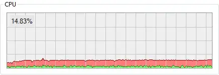

Since installing the Windows 10 Fall Creators Update, I have a svchost.exe process that is constantly using about 14​ % of CPU time:
graph of CPU utilization
