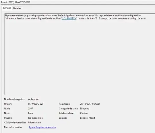

Everything worked correctly on my IIS, but I installed Windows Fall Creators Update and everything stopped working.
I get an 503 - Service Unavailable error on every app and page inside my AppPool I visit. I've checked the Windows event viewer and it says the following:
Windows Event Viewer - Error description
I've searched among the web and none of the solutions work (permissions, credentials...). I've even uninstalled completely IIS (with WAS included) and reinstalled it to reset to its factory settings. All my applications now are gone (as expected), but I still get the same error.
My system is a Windows 10 Pro (version 1709) Lenovo laptop. No updates are available on Windows Update.
More information of the error on Event Viewer:
Event Viewer more information
What's wrong with my IIS configuration and how can I make it to work again?

The issue is related to the temporary symbolic links created for the application pools by IIS/WAS being messed up during the Windows Update process for installing Fall Creators Update.
The steps to solve the problem are (at an administrator powershell):
Stop-Service -Force W3SVC
Stop-Service -Force WAS
Foreach($item in Get-ChildItem C:\inetpub\temp\appPools){
  if([IO.File]::Exists($item.FullName)){
    Remove-Item $item -Force
  } else {
    [IO.Directory]::Delete($folder.FullName,$true);
Start-Service W3SVC
Start-Service WAS
Deleting everything (files, folders and shortcuts) under "c:\inetpub\temp\apppools" will clear the temp files and the incorrect symbolic links, and starting IIS/WAS again should create them back and fix the issue.

    Thank you! Not only the files stored there, but also had to delete a folder shortcut to DefaultAppPool. After that (and reconfiguring the IIS due to the factory reset I made), it's working now!! – Unapedra Oct 20 '17 at 14:50
    Yep, I had to delete the folder shortcuts as well. Works now! – Chris Hynes Oct 20 '17 at 15:28
    While I don't think it's problematic to delete all the files in ```appPools``` folder, you can just delete the subfolder of the problematic Application Pool name as indicated in the error message. – LongZheng Oct 24 '17 at 05:55
    @LongZheng: The problem is that, after the Fall Creators Update installation, *all* AppPools become problematic. – Robson Rocha de Araujo Oct 24 '17 at 11:09
    We've hit this at Stack Overflow across so many devs and designers now. Thanks so much for posting a solution, it will save everyone here a ton of time and frustration. – Nick Craver Oct 26 '17 at 23:52
    Step 3 gave me a _"Remove-Item : There is a mismatch between the tag specified in the request and the tag present in the reparse point"_ error, but I just deleted the folder manually from explorer and went ahead with 4 and 5 - then it worked as expected. – Konamiman Oct 27 '17 at 07:48
  • @Konamiman the same thing happened for me with this answer and with the steps given by Microsoft in the KB – Alec Gorge Oct 27 '17 at 15:47
    My original answer involved using plain old DOS commands at a command prompt. I've indeed found that in some machines the remove-item command may fail, still don't know why, but manually delete everything through windows explorer also works fine in this case, as long as IIS an their related services are stopped. – Robson Rocha de Araujo Oct 27 '17 at 19:05
