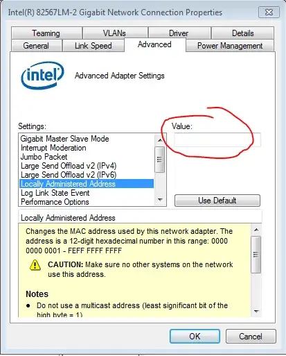

Rather than freezing or getting Windows to hang, maybe you can just interrupt the communication with your equipment.
I have no idea what your equipment is and how you connect it. If it's USB or Ethernet adapter, e.g, you could easily deactivate it in the Device Manager or unplug? If you forcefully crash or hang the system you might damage your system in various ways, so be careful with what you do.
Seth
  • 9,000
  • 34
Ralf
  • 272
    I will consider physical disconnect of the equipment if I'm not satisfied with software results. Thanks. – hypers Nov 03 '17 at 09:36
