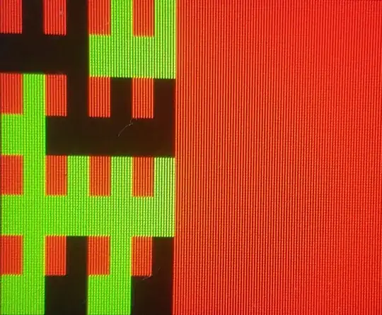

grid transmission
The right half is still a clock signal, flashing on and off to mark the arrival of new frames. But the left is now a grid where each cell is marked by a red square in the corner, and then the green cell to the right and down from the red square is flashed on and off to indicate a bit. The red squares should let the receiving computer calibrate where the cells are located. I haven't got any data across this way yet, but it's what I'm working on.
  • Someone suggested that I look into writing QR codes instead of these ad hoc color patterns. I'm going to look into that, too, and perhaps implement that instead of this grid approach. The error correction would be a nice win, as well as being able to use standard libraries to decode.
  • I learned that I have access to libasound (the ALSA sound library), but not to the header files associated with it (alsa/asoundlib.h or whatever). If anyone knows how to make use of a shared library without the headers, or can help me write just the right header to let me produce audio output, then I could have an audio-based way of getting the files out.
  • Alternately, if someone could help me manipulate the USB devices without access to libusb then maybe I could do something with that?
Moving forward!
