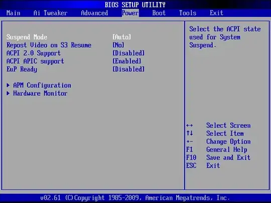

See your poweron options in bios. Maybe there is something that triggers the PC wakeup.
Try to look deeper in "Ai Tweaker" enter image description here
and "Power" tabs in BIOS enter image description here enter image description here
also maybe you need to set another Voltage values, try making them lower or higher, but don't max out.
