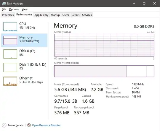

Every few days of uptime the memory usage of my PC increases without any obvious reason. Here is a typical memory usage reading after 4 days of uptime:
74% memory usage

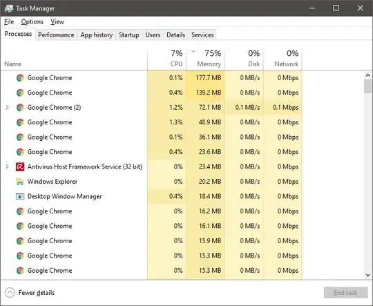

However, I've tried to trace the offending application causing any potential memory leaks. Task Manager lists the highest app usage from Google Chrome (with only ~200MB usage):
Task manager processes
Closing other apps still leaves 62% mysteriously in use:
62% memory usage after closing apps

Strangely, restarting the PC clears up memory usage, but shutting down and starting up doesn't. I assume this is due to the "fast startup" feature, but I'm not sure why it would affect memory usage.
If it matters, I am also using CleanMem as I assumed it would help alleviate any memory leak problems.
Given these, how could I pinpoint what is causing high memory usage in my system?
