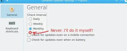

I keep getting popups about updates and it's annoying. The window below is from the taskbar icon settings that I think is causing the popup. Is there a workaround? If I knew which package was the culprit maybe I could uninstall it.

Go to Panel settings:
Panel settings
Then go to System tray settings:

Don't know for other distros, but for Fedora
dnf remove plasma-pk-updates
should solve it.

    As of Fedora 34, this package has changed to be called plasma-discover-notifier. If I remember correctly, this is because the notification has been moved from the separate plasmoid into Discover (the Plasma software center) – Sompom Apr 24 '21 at 05:55

for fedora 35
dnf remove plasma-discover-notifier

Or you can just End "Discover-notifier" process from system-monitor, although this needs to do it everytime u boot.
