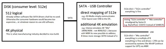

All my misconception (read "contradictory" above) resulted from the problem that there are possibly 2 emulations. 1st emulation (512e) between drive and host interface (when directly connected to internal SATA port). 2nd emulation ("4Ke") between USB and host interface (for external drives) where the USB interface is a man in the middle, delegating between drive and host. Possibly 2 emulations because it obviously depends on the controller. With Intenso ("4Ke") there is a 2nd emulation and with AS-Media ("Non-4Ke") there is not a 2nd emulation.

I have overlooked a monster: Backward compatibility!
So the correct statement is:
"The drive is 512e. The Intenso controller does emulation (as Daniel B stated) and thus the controller makes the drive visible as a "4Ke" drive to the operating system. The AS-Media controller does no emulation and therefore the drive is visible as a 512e drive to the operating system."
So I can also answer my own questions.
What would be the rational to fake the LogicalSectorSize?
Answer: Make drives over 2TB available for systems with MBR support only. Windows XP was still a giant 6 years ago.
Why does the AS-Media controller then fail to work?
Answer: Misalignment (by factor 8).
Why is 4Kn (4096/4096) reported on both operating systems?
Answer: There is no difference in representing a 4Kn drive or "4Ke" drive (=512e drive + "4Ke controller").
Summary:
512e drives ("1st emulation") allow you to use old drivers with new disks (since 2009!). "4Ke controllers" ("2nd emulation") allow you to use legacy MBR with huge disks (cf. Update 2 in question).
A side note on encryption: Using TrueCrypt or some similar tools where disks have no format (RAW, uninitialized, no file system) it is important to know that enclosures come with "4Ke" or even their own encryption(German).
The solution for me will be slowly transitioning from "4Ke" to "Non-4Ke" by reformatting all drives.
